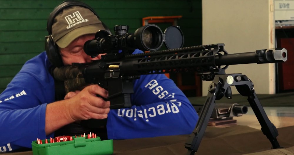

USA kaitseministeerium hakkab .300 WinMagi välja vahetama 6.5Creedmori vastu... Seda vähemalt osade(SOCOM) üksuste relvasüsteemide puhul.
Grand Island, NE — A specialized group from the U.S. Department of Defense has purchased an undisclosed amount of 6.5 Creedmoor ammunition from Hornady for its long-range sniper platform.
The 6.5 Creedmoor was tested and selected for engagements from 0 to 1,200 yards.
The purchase agreement coincides with a Department of Defense decision to replace the MK13 bolt-action 300 Win Mag with a 20-inch semiautomatic AR-10 in 6.5 Creedmoor.
With less recoil, the change will provide enhanced accuracy and performance, as well as reduced ammunition and rifle weight, compared to the MK13 300 Win Mag.
The 6.5 Creedmoor from Hornady provides world-class performance in a factory-loaded cartridge. The high-performance, match-accurate round features an excellent cartridge-to-chamber relationship and shoots well in all guns.
The 6.5 Creedmoor features proven Hornady bullets, specially selected cases, carefully matched powder and stringent quality control.

Septembris Männiku lasketiirus filmitud Nord Armsi täpsusrelvadest kaliibrites 223, 308 ja 338. Kaitse Kodu artikkel on viimase ajakirja lehekülgedel 54-59 https://issuu.com/kaitse_kodu/docs/kait ... _2020_veeb

6:31 tõrge?

oliver kirjutas:6:31 tõrge?
Kus sa sellega. Lihtsalt see on ''sniper mode'' kus põlve peal kokkuklopsitud poolauto toimetab nagu korralik poltlukk, elik ei viska kesti välja. :wall:
Kusjuures lõi laskurile laadimiskäepideme näkku.. Mis asi see neil on, DI !? :shock:
Loodetavasti on suudmepiduris auk keskel muidu ei tule sealt kuule ka välja..
Ah jaa, loodetavasti on sihikus niitrist keskel, mitte nagu mingitel KL liikmete binoklitel, muidu kui kuulid välja ei tulevad, siis Alfasid ei tule....

gorilla kirjutas:Lihtsalt AR15 lihtsalt üles skaleerides ei saa sellest iialgi elulooma. Tehke kaliibris 8.6x70 oma aretisele 2000 lasu test, viige Inspecta OÜ röntgeni alla, näidake kuidas on upperis mikropragudega.
No mitte ainult. Oma laksu saavad kätte ka lukupea lukustushambad, mis mikromõrade arenemisel lihtlabaselt ära murduda võivad. Kui seda juhtub isegi 5,56 kaliibriga relvadel mõnikord (küll suure lasuarvu juures, aga siiski), siis 338-l on see seda enam koht mida hoolega silmas pidada.
Tuleb muidugi öelda subjektiivselt, et niipalju kui ma seda aparaati lasknud olen (suht vähe siiski, ja ütlen et ei, ei ole mina videos või sellega seotud, seega pole mõtet küsimusi esitada), oli suht pehme lasta küll, arvestades kaliibrit ja kaalu.
