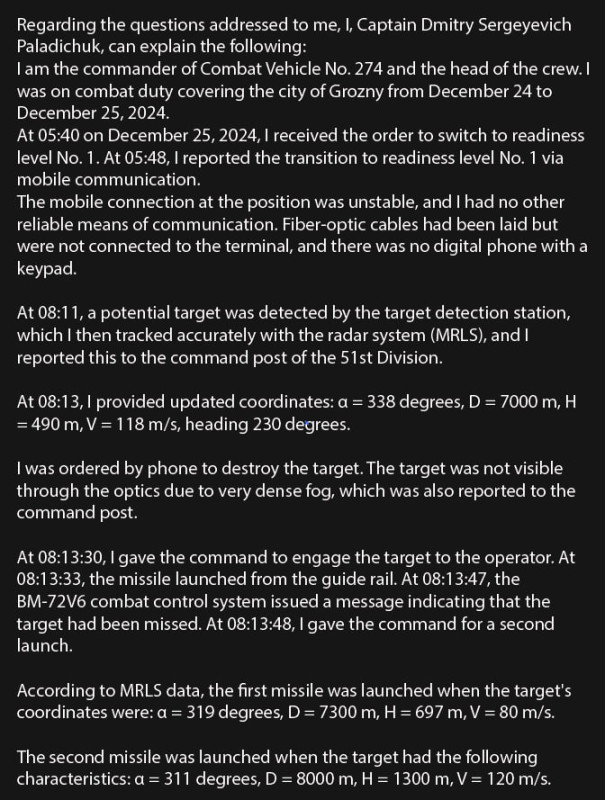

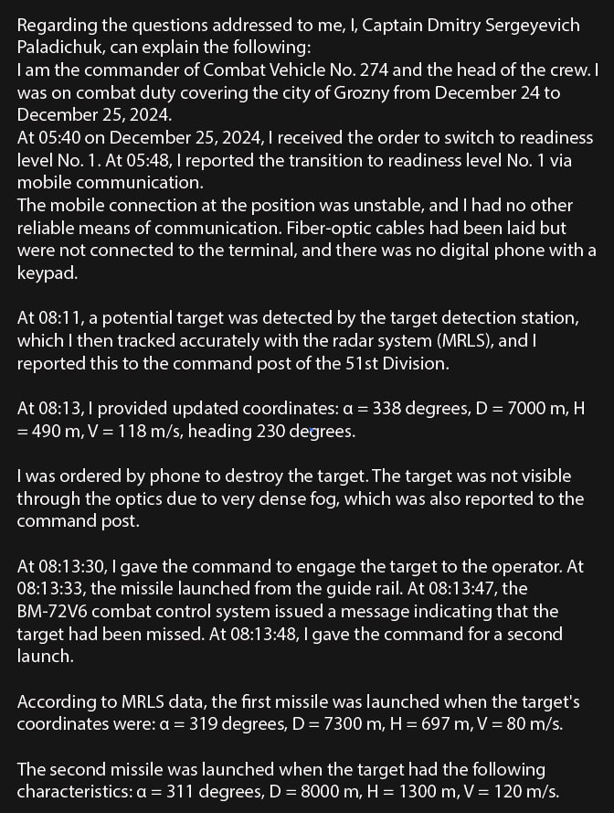

Keegi siin selgitab olukorda
https://t.me/wartranslated/6761?single
The outlet Minval claims that the letter they received contains an explanatory note from a Russian air defense captain, who states that fire was opened on the Azerbaijani aircraft on orders from the Russian Ministry of Defense. The letter also includes video footage, audio recordings, and details about the poor condition of the equipment.

See ei ole selgitus, see on lihtsalt tõlge. Venekeelne originaal on ZRK meeskonnaülema (auaste kapten) ettekanne toimunust intsidendist lahingvalves nr1 24-25.12.2024. NB! See ettekanne on PVO-PRO ülemale tehtud (tõenäoliselt sisejuurdluseks) 27.12.2024, s.o. kaks päeva peale lahingvalvet.
