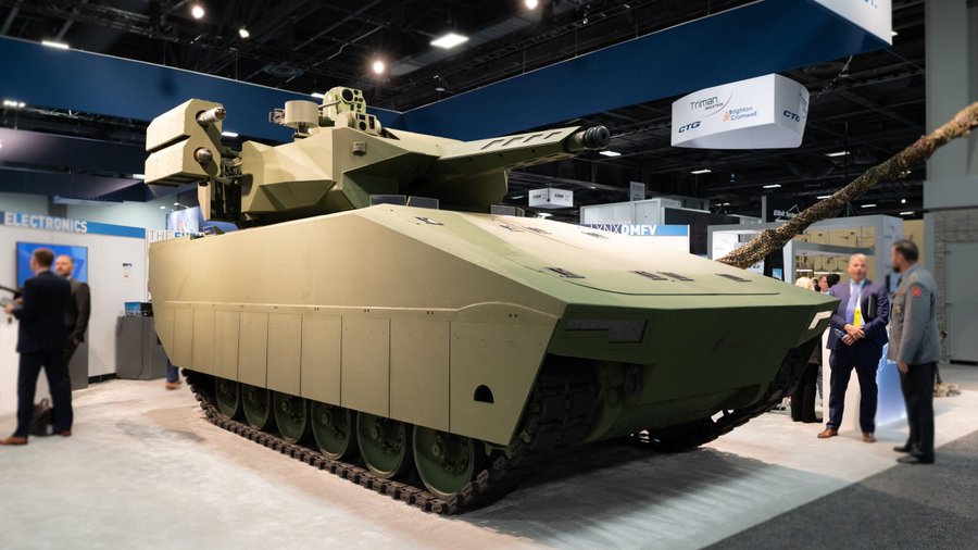

USA vahetamas 2027 välja Bradley M2 IFV-d.
The US Army's XM30 will replace the M2 Bradley from 2027. It has given General Dynamics and Rheinmetall $800 million each to develop prototypes. The OMFV program is worth $45 billion with the US Army expected to purchase some 3,800 units.
The XM30 is likely to redefine the IFV category. To this end, it will feature a 50x228 mm cannon in a remote-controlled turret. This will have twin ATGMs, advanced sensors, an AI-enabled Fire Control System, MBT-levels of protection, and a hybrid drivetrain.
XM30 will have a crew of two (driver + commander) and will carry an infantry squad of 6. A reduced capacity will ensure that the vehicle is not too large and heavy relative to Bradley. XM30 will work closely with future versions of the M1 Abrams and both vehicles will be well protected against UAS threats.
If the British Army wants a new IFV, it should consider becoming a program partner and look to acquire whichever vehicle wins the competition. Any purchase agreement should include building the vehicle in the UK with a local supply chain to support it.

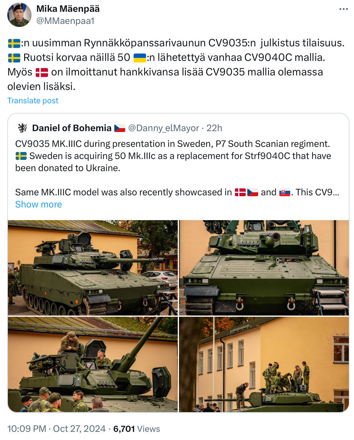

Taani ja Rootsi hangivad nii endale, kui Ukrainale
Today, Swedish and Danish defence procurement authorities have signed a contract with BAE Systems Hägglunds worth SEK25 billion to procure 205 CV 90 infantry fighting vehicles. 115 will go to 🇩🇰, 50 to 🇸🇪 and 40 are jointly procured by 🇩🇰 and 🇸🇪 for 🇺🇦.
BAE Systems Hägglunds, this year celebrating 125 years, has for many decades delivered innovative infantry fighting vehicles and other materiel to the Swedish Armed Forces.
The CV90 vehicles will be equipped with the latest CV90 turret and provide their crews with increased mobility, protection, and lethality. In 🇺🇦, the Swedish CV90’s is defending Europe´s security and today’s contract will give 🇺🇦 even more strength to carry out that task.
