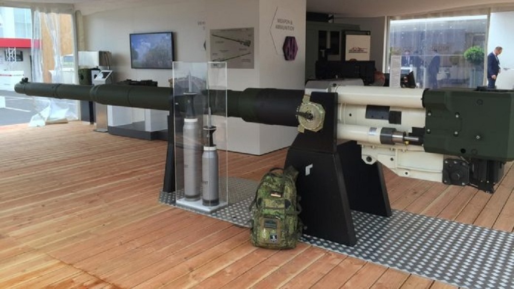

Penetraatori pikkus peab olema vähemalt 1m, et loota Leo2A7 vastu midagi ära teha.
Mass korda kiirus jagatud läbimõõt on teema. Massi pole kui su penetraator on 600mm pikk, kui teha jämmem siis on läbivusega
hambad. Nõiaring. Selleks on sakslaste 130mm selline nagu alloleval pildil näha. Good luck ajudoonoritel seda vertikaalselt korpusesse toppida.

TTA kirjutas: Vene tankidel on mürsk ja heitelaeng eraldi. Põgusal sirvimisel leidsin 680mm pikkuse mürsud: https://en.wikipedia.org/wiki/125_mm_sm ... ammunition. Seega on ruumi natuke rohkem.
Niipalju kui ma ennist tsiteeritud tekstist aru sain, siis Armatal ei ole heitelaeng ja mürsk eraldi, sest see paneb liiga suured piirid noolmürsu pikkusele (mis "Vaakum-1" juures peaks olema 900mm(. Samuti ei ole kahur sama mis T-90el:
Firepower:
The T-14 introduced a significant firepower upgrade in the form of a new 125mm smoothbore gun: the 2A82–1M. The 2A82–1M’s predecessor was the 2A46, which has equipped all Russian designs from the T-64 all the way to the T-90. Needless to say that an upgrade was direly needed at this point. First of all, the 2A82–1M is longer than its predecessor. The 2A46 had a length of 48 calibres (exactly 6 meters long),
while the 2A82–1M seems closer to 55 calibres (see image below):
Russia claims a 15–20% increase in accuracy with this new gun, and I’m inclined to believe those claims. In theory, increased barrel length leads to increased velocity, and the 2A46 gun used by the T-90 already had exceptional velocity on its APFSDS ammunition (~1800m/s). I suspect the 2A82–1M provides slightly better muzzle velocity than its predecessor, perhaps 1850–1900m/s. Therefore, there’s no way around it: compared to the Leopard 2 (Rheinmetall L55), the M1 Abrams (M256) and the Challenger 2 (L30), the T-14 Armata probably has a better gun, with more velocity and similar levels of angular dispersion at range. However, a better gun doesn’t necessarily lead to better overall firepower, as we’ll see later on.
