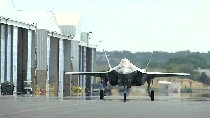

F-35 lähilahingus. Norra piloodi perspektiiv: Allpool on sama artikkel inglise keeles, pole vaja Google Translate'i kasutada :)
Another aspect is the kind of reaction I get when I push the stick forward; the F-35 reacts immediately, and not delayed like the F-16. Looking at another F-35 doing such maneuvers is an impressive sight. The various control surfaces on the airplane are large, and they move very quickly. I can monitor these movements on the screens in my cockpit, and I´m fascinated by how the control surfaces move when I manipulate the stick and pedals. Especially at high AOA, it is not always intuitive what control surfaces move, and by how much.
Antud jutu kohta, mis käis lennuki tagatiibade ja kaldtüüride liikumisulatusest ja agiilsusest oli kaasa pandud illustreeriv video ruleerimisel. Lisan selle siia:
OHxWCZF - Imgur.gif (15.26 MiB) Vaadatud 8397 korda
The final «textbook» for how to best employ the F-35 in visual combat – BFM – is not written. It is literally being written by my neighbor, down here in Arizona! We have had many good discussions on this topic over the last few weeks, and it feels very rewarding to be part the development. I would emphasize the term “multirole” after experiencing this jet in many roles, and now also in a dogfight. The F-35 has a real bite! Those in doubt will be surprised when they finally meet this «bomber”.
