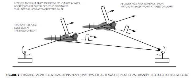

Raamatus "Alternate Radar Concepts", peatükis "Bistatic Radar" (lk 14-15) on sedasorti radaritest ning nendega seotud probleemidest räägitud. Tsiteerin:
■ In a military scenario where point targets are usually defended with radar, where should the transmitter and receiver antennas now be located?
■ Two antenna beams, one transmit and one receive, must intercept each other.
■ The receiver antenna beam must “chase” the transmitter pulse at the speed of light.
■ A transmitter reference signal is required for coherent processing.
■ Distance measurement is much more difficult because echo time is the sum of the distance from transmitter to aircraft to receiver.
■ And for extreme forward scattering, how is the echo distinguished from the direct transmitted pulse?
Need on ainult kokkuvõtvad küsimused. Raamatus on seda teemat veidi pikemalt lahatud ning neile vastuseid otsitud. Antud peatükk on umbes 1,5 lk mõttega lugemist. Soovitan seda teha, et mõista, MIKS millegi sihtimine sellisel printsiibil niivõrd keeruline on (miks mainitakse küsimustest näiteks valguskiirust).
Screen Shot 2016-08-17 at 17.21.16.png (49.65 KiB) Vaadatud 5861 korda
