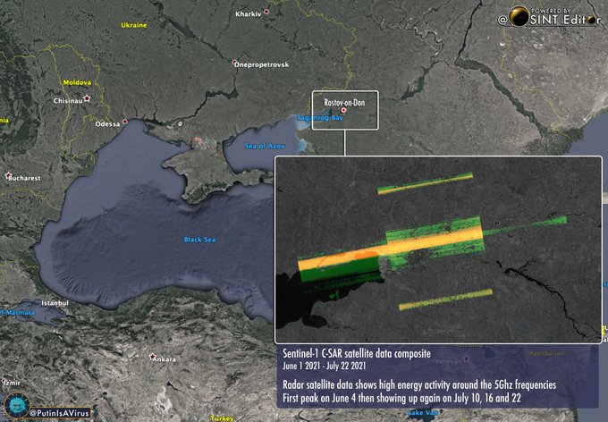

Venelastel midagi uut EW vallast Rostovi piirkonnas käima tõmmatud.
Sentinel-1 data suggests that #Russia has a new toy which has tested/activated somewhere near Rostov-on-Don.
Still hard to pinpoint the source, but the interferences recorded by the C-SAR satellites are among the strongest ever detected and have a unique pattern.
https://twitter.com/PutinIsAVirus/statu ... 3572443137
Võimalik kandidaat süsteemi asukohale
47°21'15.48"N 39°47'3.97"E Seems to be a good candidate.
https://twitter.com/Tasca_Lumina/status ... 5633416202
