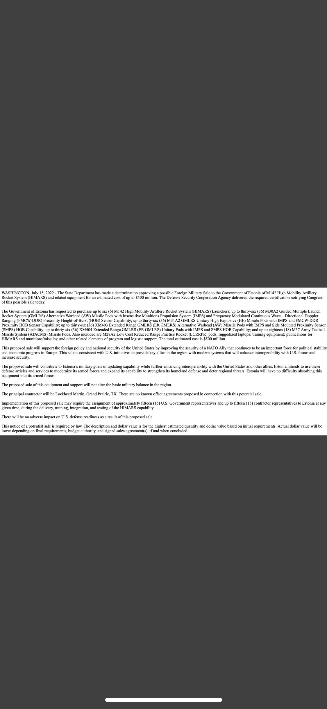

Eelmise postitusega seotud. Kauba hulgas ka ATACMS raketid. Vabandage teksti eest: see võetud fotost telefoniga.
The Government of Estonia has requested to purchase up to six (o)
M4/ High Monilv Artilerv Rocker vstem (HiM A R
Launchers; up to thirty-Six (36) M3UAZ Guided Multiple Launch
uous wave - Directional Di
Kanging (EMC.W-DUK) Proximity Height-ot-kurst (HOB) Sensor Canabilitv: un to thirtv-SIX (36)) MS1 AZ GMI.KS Unitarv High Exnlosive(HE) Missile Pods with IMPS and EMCW-DUR
Proximity HOB Sensor Capabilitv:
• up to thirty-six (36 XM403 Extended Range GMLRS (ER GMLRS) Alternative Warhead (AW) Missile Pods with IMPS and Side Mounted Proximity Sensc
Range GMILRS (ER
GMERS) Untarv
Pods with IMPS and SMFS HOB Capability; and up to eighteen (18) MS/ Army lactical
Missile System (ATACMS) Missile Pods. Also included are M28A2 Low Cost Reduced Range Practice Rocket (LCRRPR) pods: ruggedized laptops; training equipment: publications for
HIMaks and muntons/missiles: and
related elements of program and logistic sunnort I he foal estimated cost is lu million.HIMaks and muntons/missiles: and
This proposed sale will sur
of the United stat
by improving
the scutv
and economic progress in Europe. This sale is consistent with U.S
- initiatives to provide
key allies in the region with modern systems that will enhance interoperability with U
The proposed sale will cr
detense articles and services to modernize its
With the United States
proposed sale of this equipment and supp
ort will not alter the basic military balance in the re
The principal contractor will be Lockheed Martin, Grand Prairie, TX. There are no known offset agreements proposed in connection with this poter
Implementation of this proposed sale may require the assignment of approximately fifteen (15) U.S. Government representatives and up to fifteen (15) cc
ation, and testing of the HIMARS capabilitv
There will be no adi
verse impact on U.S. defense readiness as a result of this proposed sale
potential sale is required ov law. The descriotion and dollar value is for the highest estimated
Re: Uued relvasüsteemid EKV-le
Viide esialgsele avaldusele ka: https://www.dsca.mil/press-media/major- ... tem-himars
Hind võib suur tunduda, aga soovitan tähelepanu pöörata raketikonteinerite kogustele.
72 GMLRS (70+ km), 72 ER GMLRS (150 km) ja 18 ATACMS konteinerit (300+ km).
See kõik kokku tähendab 882 raketti.
Loomulikult ei tähenda see DCSA teade, et sellised kogused ostetakse. Tavaliselt pannakse sinna asju varuga, et kui hiljem peaks tekkima soov midagi juurde võtta, ei pea uuesti bürokraatia kadalippu läbima. Tegelikkuses saab esimene leping tõenäoliselt palju väiksem olema. Samas on hea teada, et KV on mõelnud ka tiba kaugemale ja palunud vägagi arvestatavat kogust moona. Iga konflikti järel ju tõdetakse, et selle kulu on palju suurem kui oodati.
