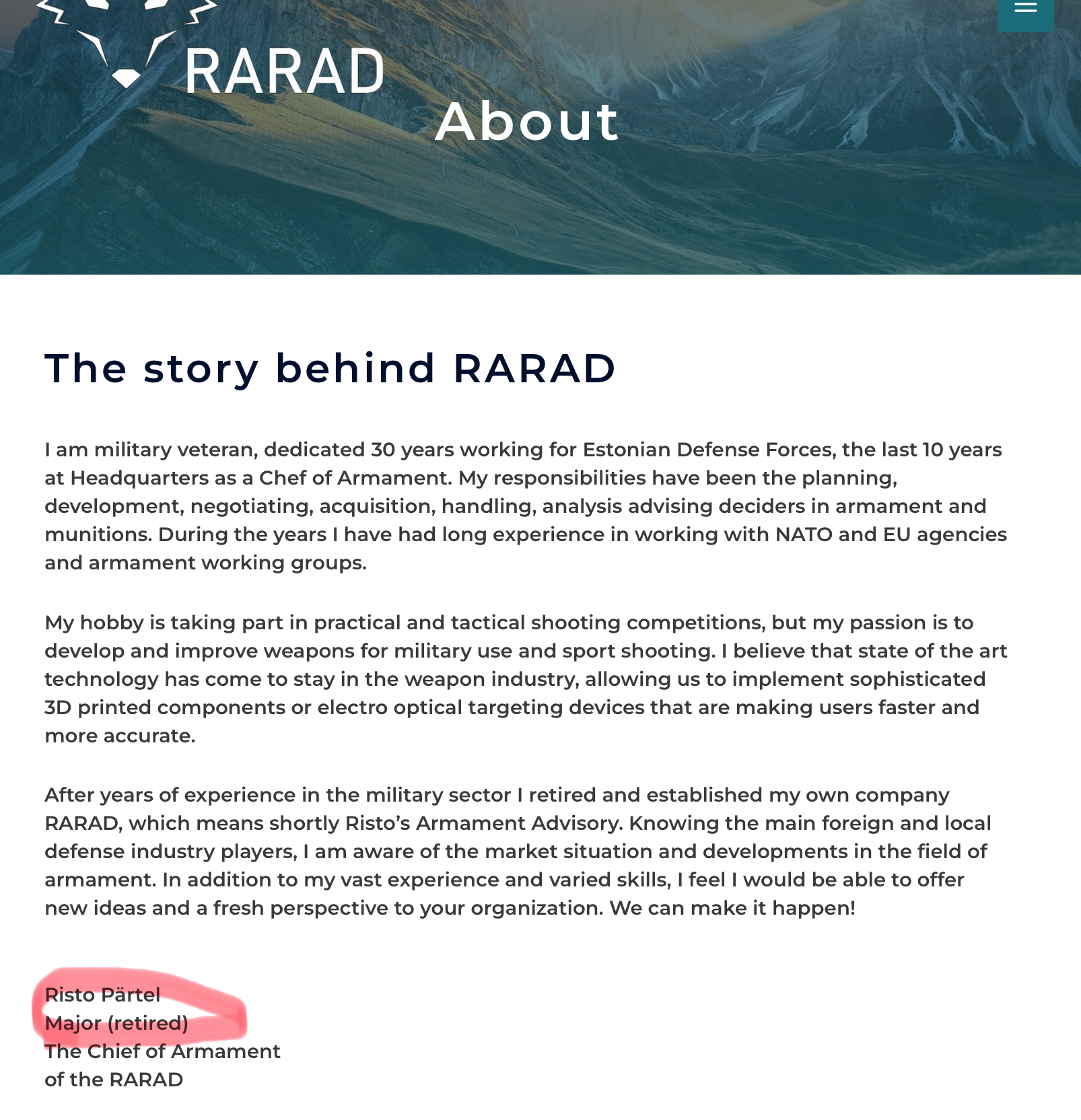

Major Pärtel on pensionil.
https://rarad.ee/about/
